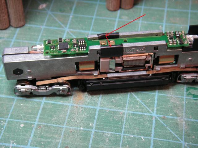

Voilà un exemple sur une Dash 8 Atlas, tu noteras l'isolation du châssis à l'endroit ou se trouvent les pattes du moteur.

Je ferai une photo à l'occasion, mais ça ressemble à ça.

la reponse est la
under conventional DC will also run exceptionally well under DCC.
The LE063XF decoder is quite small and will fit into the B23-7, B30-7,
B36-7, Dash 8-40B, GP-38, DCC-ready GP-40, GP-40-2, DCC-ready
SD-7, DCC-ready SD-9, SD-35, Train Master, and U25B locomotives.
Precautions to Take When Installing the Decoder:
Although the LE063XF decoder has many internal safeguards to prevent
damage, you must not allow any metal part of the locomotive to touch
surface components of the decoder other than the pickup pads on the
decoder that connect to the wheel-sets, the headlights, and the motor.
Any contact to other parts of the decoder can cause a direct
internal short circuit and destroy the DCC decoder.
The LE063XF decoder is not completely protected against static
electricity and has sensitive electronic parts. When installing this
decoder in your N scale locomotive, it is recommended that you wear a
grounded anti-static wrist strap. Also be careful in handling the decoder,
especially in the area around the top rear part of the decoder (the area
where the microprocessor is located).
il faut isole le chassis du decodeur
