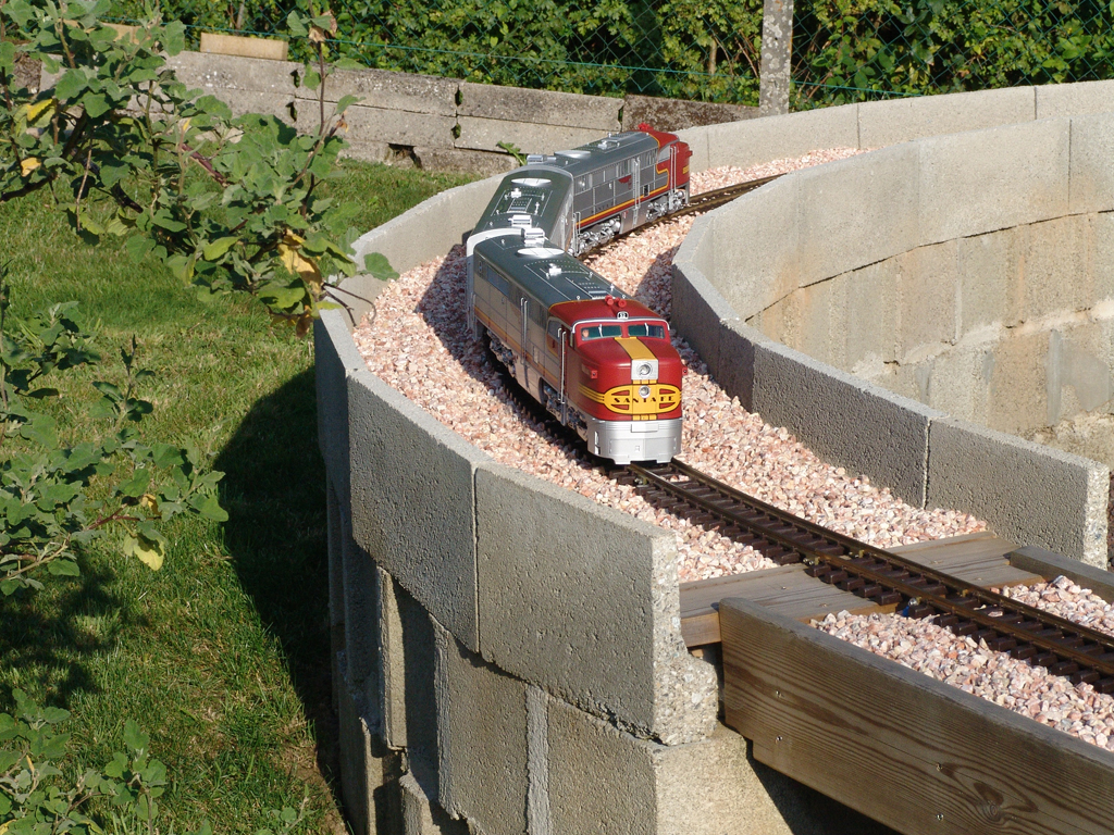

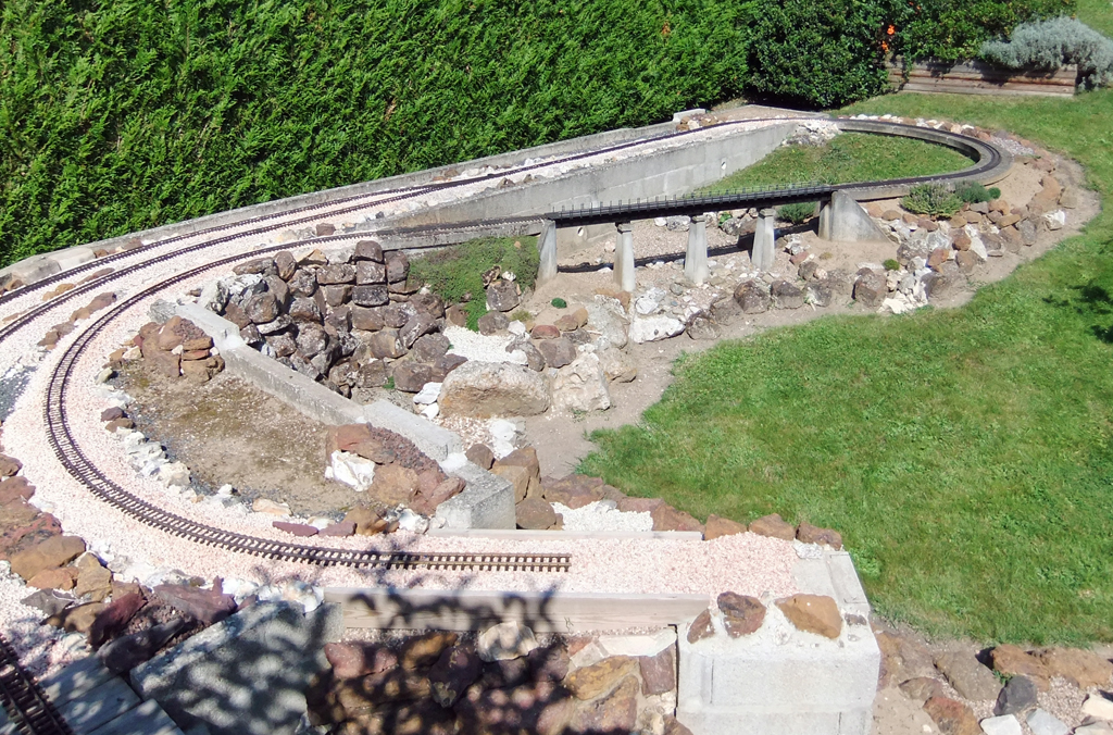

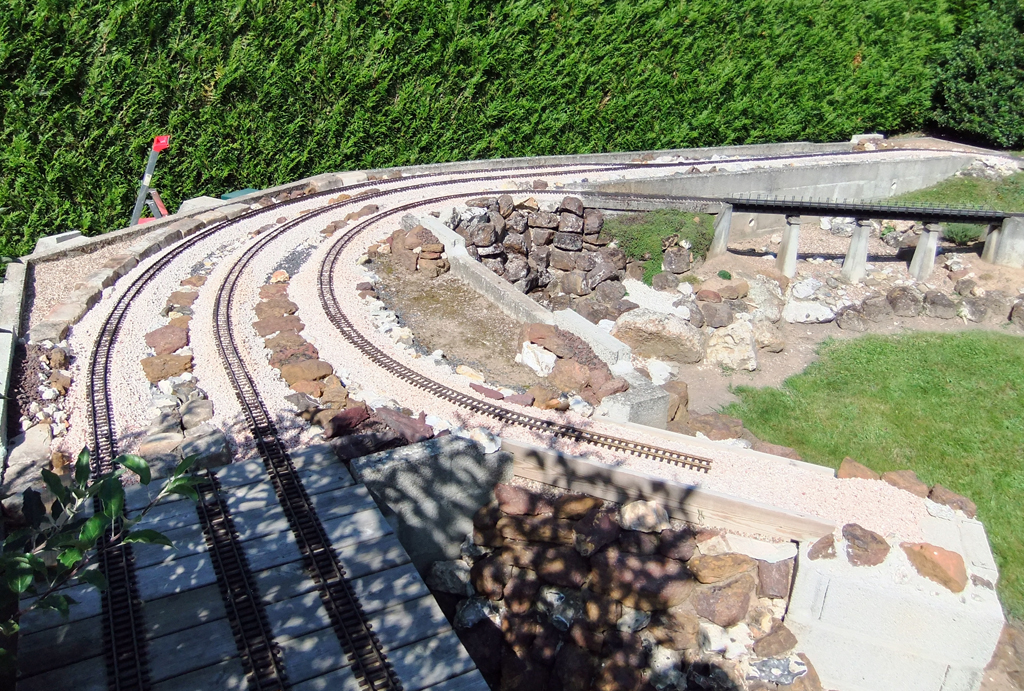

VOILA JE ME LANCE POUR VOUS PRESENTER MON CIRCUIT

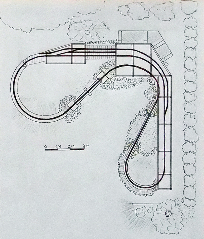

D'ABORD UN DESSIN POUR LE TRACE

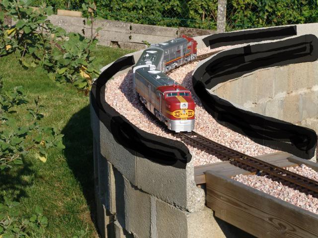

MON TERRAIN EST EN PENTE (10%) LE TRAIN LUI C' EST 0% POUR QUE CA ROULE D'OU L'OBLIGATION DE CREER UN SUPPORT : CE SERONT DES MASSIFS EN PARPAINGS
REMPLIS DE DE TERRE C' EST TRE TRES LONG A FAIRE MAIS C' EST PLUS SYMPA QUE DE REGARDER LES TRAINS PAR TERRE SURTOUT QUE
MES YEUX SONT A 1M80 DU SOL

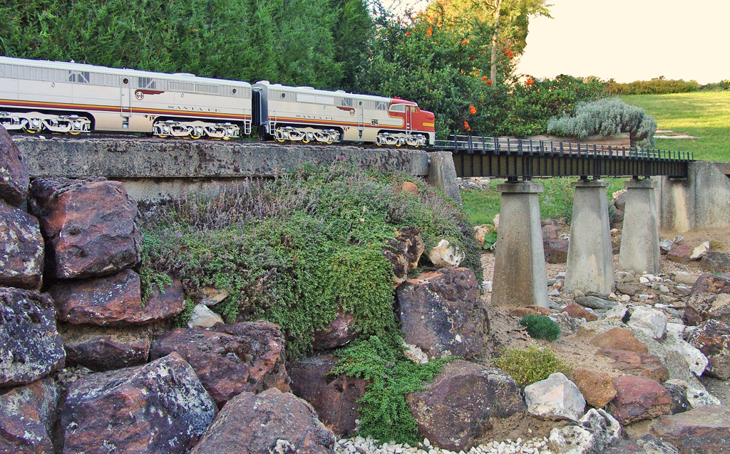

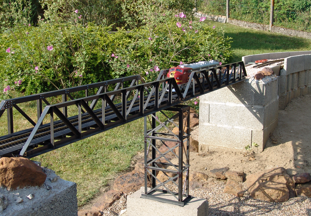

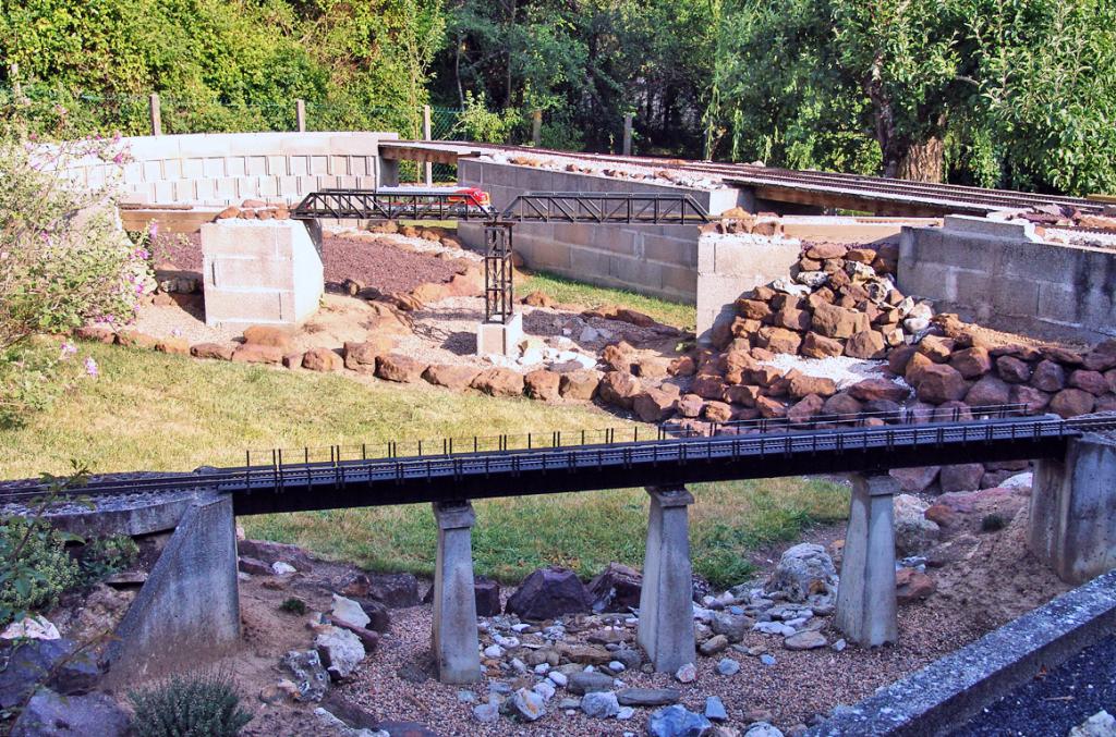

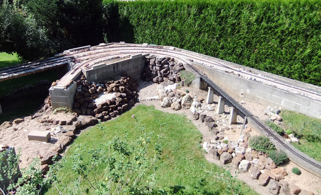

SUR CETTE PHOTO IL MANQUE ENCORE LE 2EME PONT. JE FABRIQUE EN CE MOMENT LES SUPPORTS POUR LE FIXER

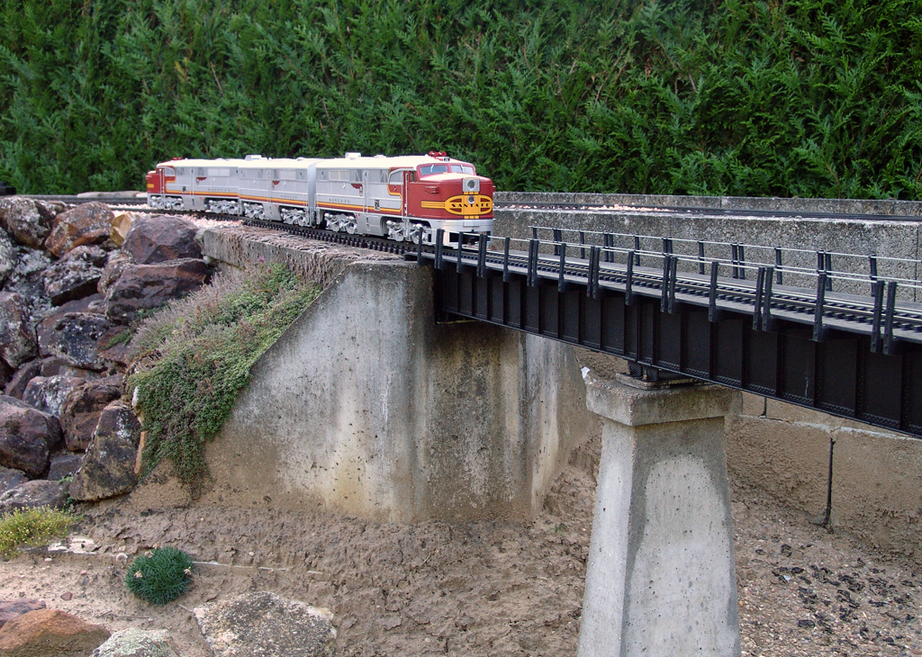

LE PONT AU PREMIER PLAN EST DE CHEZ GARDEN METAL MODELS ET EST COMPOSE DE 4 TRONCONS DE 60 CM

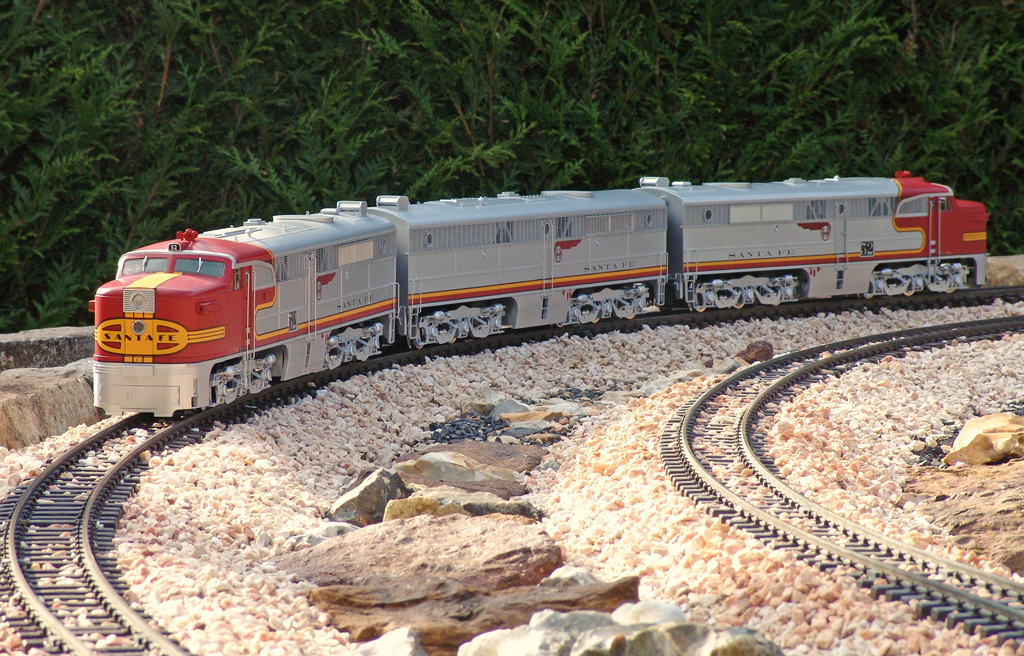

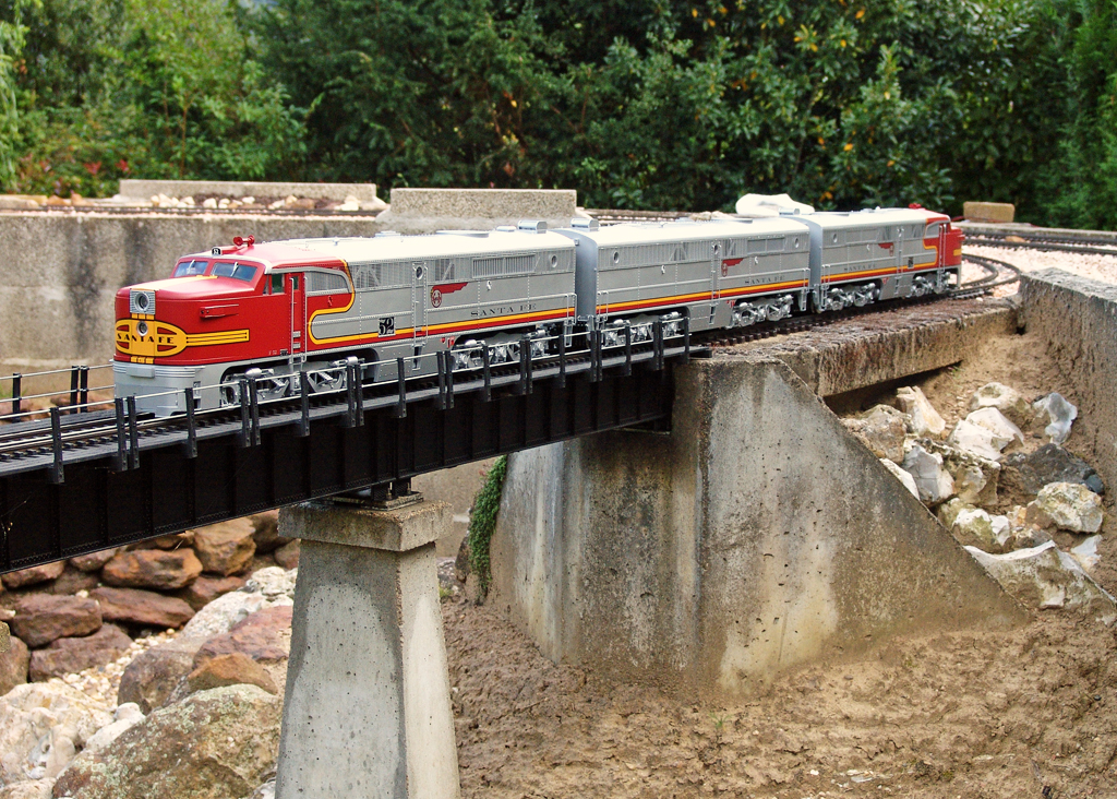

CE PONT EST DE FABRICATION MAISON EN CORNIERES D' ACIER ASSEMBLEES PAR VIS/ECROUS (L'OCTANT) LA LOCO EST UNE ARISTO E8
CELA DONNE UNE IDEE SUR LA DIMENSION DE L'OUVRAGE (LONGUEUR 2,50M) BRUT POUR SON CALAGE AU MOMENT DE LA PHOTO, IL SERA PEINT
CET HIVER EN ROUGE BASQUE

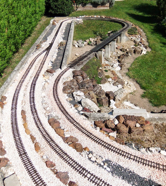

VOICI EN GROS LES CARACTERISTIQUES DU CIRCUIT
- LONGUEUR DE LA VOIE PRINCIPALE ENVIRON 42M
- RAIL LGB RAYON MINI 1.60M
- AIGUILLAGE LGB R5
- ASSEMBLAGE DES RAILS PAR ETRIERS HILLMANN
- BALLAST EN GRAVIER DE MARBRE ROSE (LCI PIERRE) CA CALE BIEN LES RAILS MAIS CA COUTE UN BRAS !........
- ALIMENTATION ELECTRIQUE PAR LES RAILS (PAS DE DIGITAL) EN CANTON ISOLES, CELA EVITE LES PERTES DE COURANT

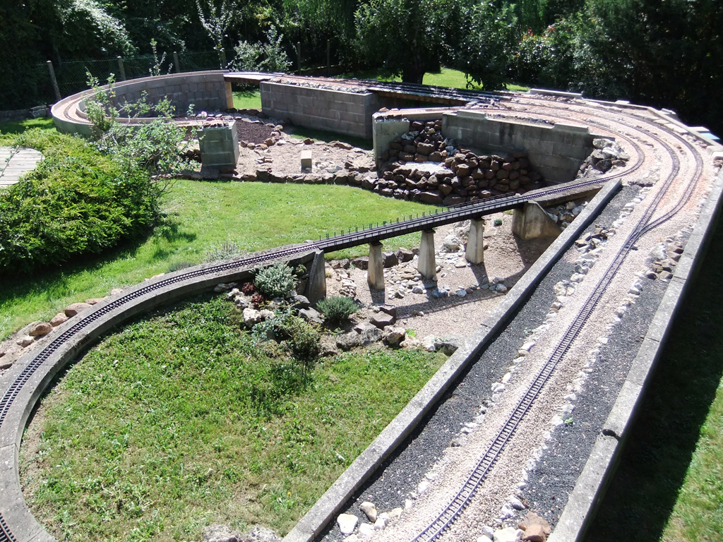

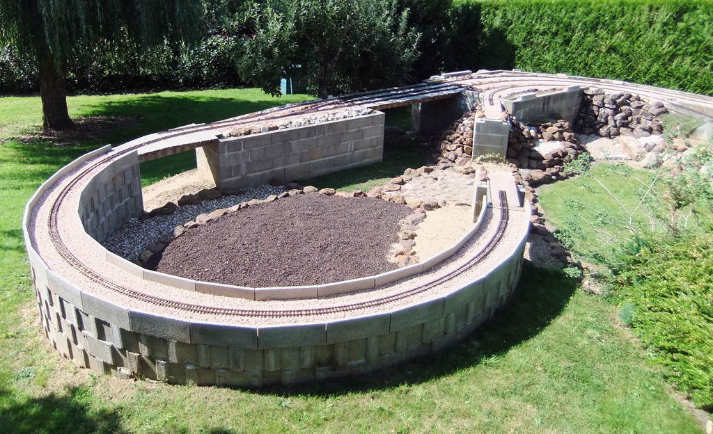

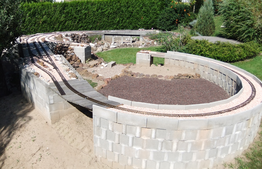

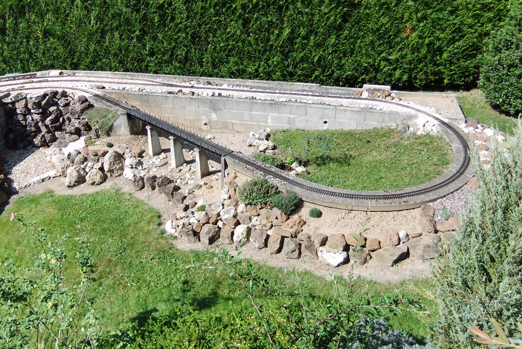

ALLER VOICI LE RESTE DES PHOTOS
